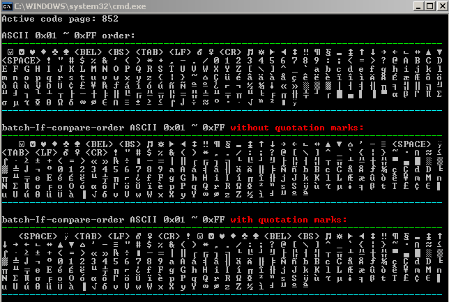

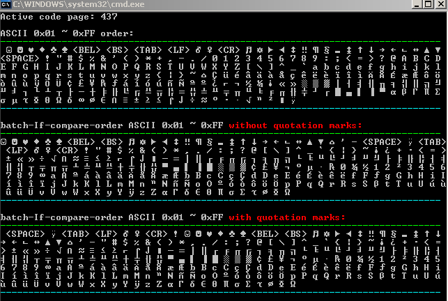

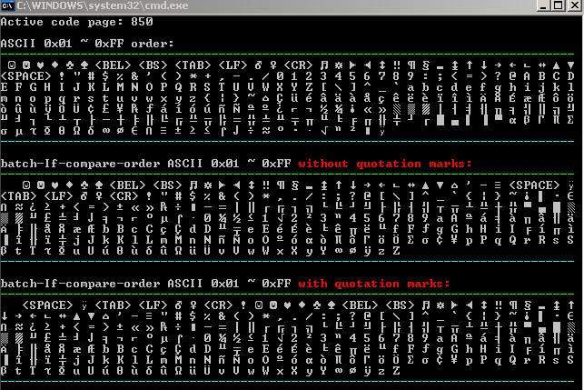

先把运行结果贴出来和大伙分享下(点击图片看大图):
437代码页:
850代码页:
852代码页:

  1. Active code page: 437
  2. 带引号:
  3. order=32,255,9,10,11,12,13,33,1,2,3,4,5,6,7,8,14,15,16,17,18,19,20,21,22,23,24,25,26,27,28,29,30,31,127,39,45,34,35,36,37,38,40,41,42,44,46,47,58,59,63,64,91,92,93,94,95,96,123,124,125,126,173,168,43,249,60,61,62,241,174,175,246,251,239,247,240,243,242,169,244,245,254,196,205,179,186,218,213,214,201,191,184,183,187,192,212,211,200,217,190,189,188,195,198,199,204,180,181,182,185,194,209,210,203,193,207,208,202,197,216,215,206,223,220,221,222,219,176,177,178,155,156,157,170,248,230,250,158,48,172,171,49,50,253,51,52,53,54,55,56,57,236,97,65,166,160,133,131,132,142,134,143,145,146,98,66,99,67,135,128,100,68,101,69,130,144,138,136,137,102,70,159,103,71,104,72,105,73,161,141,140,139,106,74,107,75,108,76,109,77,110,252,78,164,165,111,79,167,162,149,147,148,153,112,80,113,81,114,82,115,83,225,116,84,117,85,163,151,150,129,154,118,86,119,87,120,88,121,89,152,122,90,224,226,235,238,233,227,229,228,231,237,232,234
  4. 不带引号:
  5. order=1,2,3,4,5,6,7,8,14,15,16,17,18,19,20,21,22,23,24,25,26,27,28,29,30,31,127,39,45,32,255,9,10,11,12,13,33,34,35,36,37,38,40,41,42,44,46,47,58,59,63,64,91,92,93,94,95,96,123,124,125,126,173,168,43,249,60,61,62,241,174,175,246,251,239,247,240,243,242,169,244,245,254,196,205,179,186,218,213,214,201,191,184,183,187,192,212,211,200,217,190,189,188,195,198,199,204,180,181,182,185,194,209,210,203,193,207,208,202,197,216,215,206,223,220,221,222,219,176,177,178,155,156,157,170,248,230,250,158,48,172,171,49,50,253,51,52,53,54,55,56,57,236,97,65,166,160,133,131,132,142,134,143,145,146,98,66,99,67,135,128,100,68,101,69,130,144,138,136,137,102,70,159,103,71,104,72,105,73,161,141,140,139,106,74,107,75,108,76,109,77,110,252,78,164,165,111,79,167,162,149,147,148,153,112,80,113,81,114,82,115,83,225,116,84,117,85,163,151,150,129,154,118,86,119,87,120,88,121,89,152,122,90,224,226,235,238,233,227,229,228,231,237,232,234
具体代码见:http://www.bathome.net/redirect.php?tid=12762
